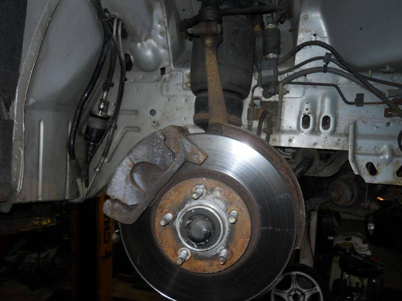

I'm replacing most wear parts in the front wheel wells on a Gen2.
I've got the the calipers off, but I'm having difficulty removing the rotors.
I've read instructions that mention using a philips screwdriver to remove a single screw holding the rotor on.
Is there screw to remove ?
I've used SuperTech lubricant, but to no avail.
Is this a matter of the rotor being rusted on and having to hammer it off with force ?

If there was a screw holding it on it would be right in middle of wheel studs. I don't think MK's have them. Good thing about new rotors is you can get tough removing old ones. HAMMER.

pulled rotors off a gen 2 (97) the other day. no screws. the rotors were original and stuck so i used the big hammer.
my 93 didn't have screws either.

If you took the caliper bracket off as well, then they should just slide off. That bracket is all that holds them in place on mine.

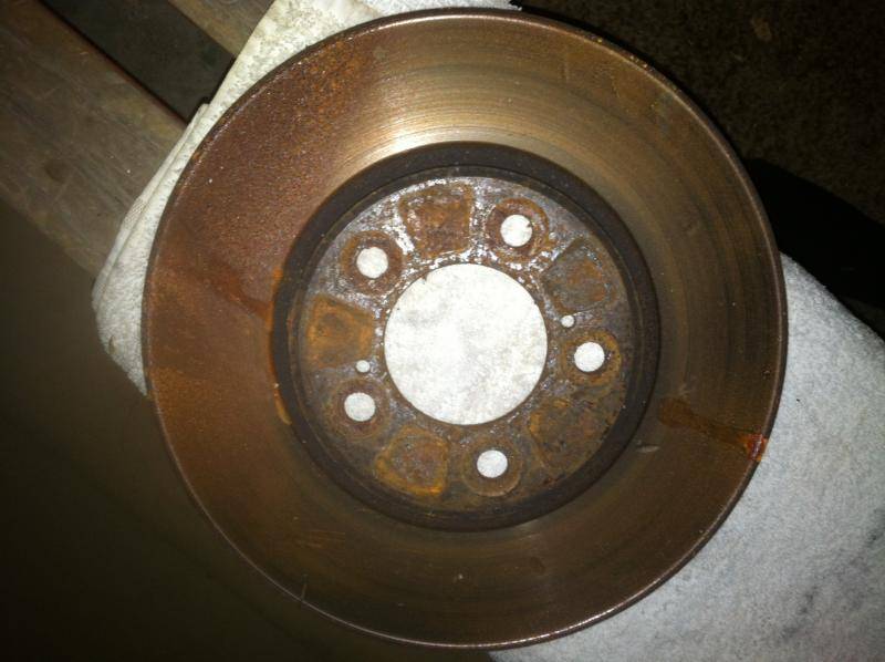

I believe the rotors are original.
I did notice the two small holes on the rotor, but putting a flathead and philips screwdriver in them didn't catch on anything.
To be clear, when hammering the rotors, I don't need to be concerned about the two holes or removing any screws or bolts, correct ?

I knew that sledgehammer would come in handy one day.
(1 hit + turn) x 5 = loose, removable rotors
They didn't even break.
