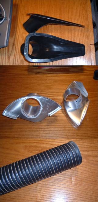

I added some brake ducts to my LS - intakes from the lower front grill - through tubing - into the wheel spindles.
Here's what I used:
black NASCAR Race Car NACA vents - $16 eBay
www.pitstopusa.com
ALLSTAR LH/RH ALUMINUM SINGLE SPINDLE DUCT - $32 each
10 feet of HEAVY DUTY / QUICKCAR NEOPRENE DUCT HOSE - $47
Then trim the spindle duct to fit.

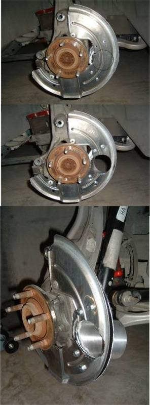

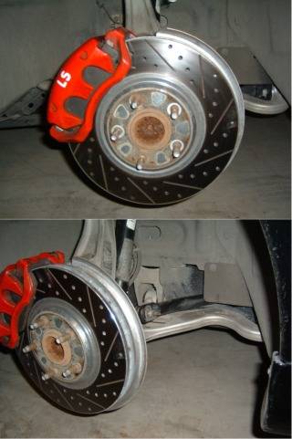

Next cut a hole through the guard so the air flows through the spindle onto the Rotor.

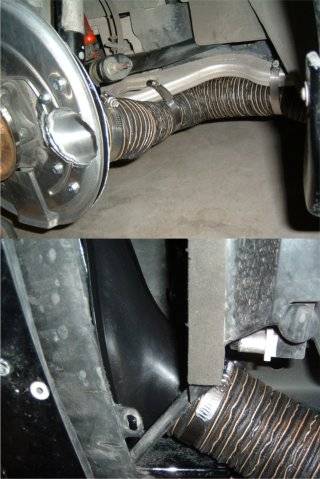

Then attach the hose, clamp it on to the spindle duct, the clamp it in spots to the arm - you'll need to test the proper slack in the hose by moving the steering wheel fully left-and-right to make sure there is just enough to reach.

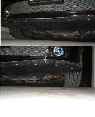

Then cut a hole in the plastic shroud just to the left and right of the radiator - place the vents just behind the grill and through the hole - attach the duct hose.
