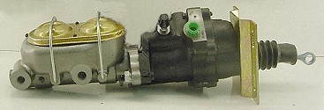

Lincoln introduced the Hydro Boost on the 1974 Continental. I think GM originally introduced the system many years before. It uses pressure from the power steering system for assist and can provide higher and more reliable braking power. It's likely the LS with AdvanceTrac and BrakeAssist would have it.
I have a friend whose brother rebuilt a few Mercury Comets & a popular mod was to grab the Hydroboost setup from a 70s Lincoln. Quick internet search found this pic:
Whether or not an LS equipped with Brake Assist uses something similar I cannot say.
Yes, I know about the earlier Lincolns with it. The LS doesn't have it. It's vacuum. All you have to do is look at your LS.
