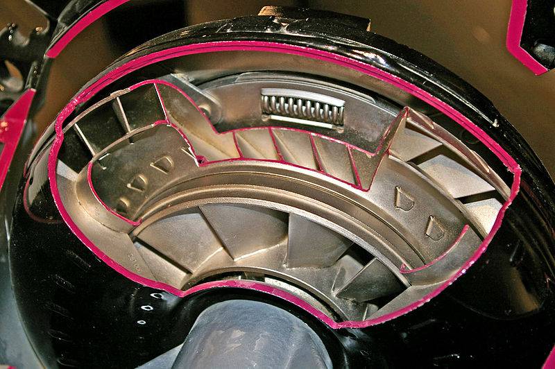

The torque converter is not inside the transmission. It is between the engine and transmission in the bellhousing.
A cutout of a torque converter. See that little spring? Its an anti-rattle spring for the torque converter lockup clutch. When that clutch is engaged the torque converter acts as a mechanical coupling between the engine and transmission instead of a fluid coupling. Those springs provide the same beneift as the anti-rattle springs in a normal clutch. They help prevent clutch chatter when it is engaged. Those springs can wear out, or break even, and then they rattle around in there while the torque converter is spinning. Thats really the only loose part inside a torque converter except for the bearings on the stator.
