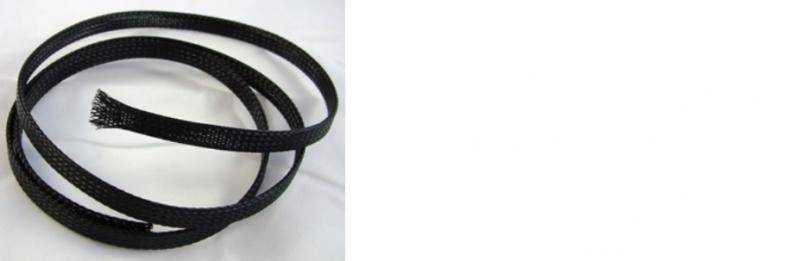

To get the dipstick out without doing any damage to the tube, you can use one of these in a small VIIIth" diameter.
Its called a PET expanding wire mesh loom, braided wire loom or sometimes refered to as Techflex.
Just shove the expanded end down the tube as far down as it can go around the dipstick, then pull up with a slight tug.

Also known as "Chinese finger trap"
Theres a seal on the handle for the dip stick. Anytime I've seen the handle break off, the piece with the seal is still inside the tube. If that's the case, he won't be able to feed that beyond it. What I've done before is find a tiny drill bit, drill the bit down into the plastic, and release the bit from the drill, then pull on the drill bit to extract the dip stick
