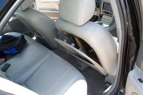

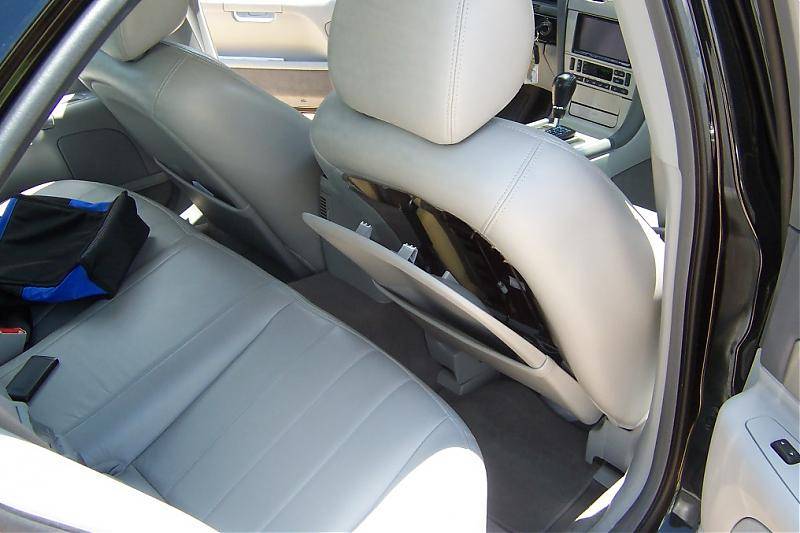

Has anyone else had problems with the seat backs breaking? In the past month the plastic backs to both of the front seats have fallen off. They just snap into place with plastic hooks, the hooks have sheared off both seats. I haven't even had anyone in the back seat, the only thing I can think of is heat, with a black interior the thermometer has been reading 120+ most days after work.

You mean like this:
Happened to both my front seats last summer. There is a TSB on this issue and it is due to "high ambient heat" according to the bulletin. Luckily both of mine were replaced under warranty. I hear they are over $100 a piece. Definitely a poor design.

You mean like this:
Yeah, like that.

i did the same idea, epoxy and some hooks, but i still have them off so i'll take some pics so everyone can understand what we're talking about:)
