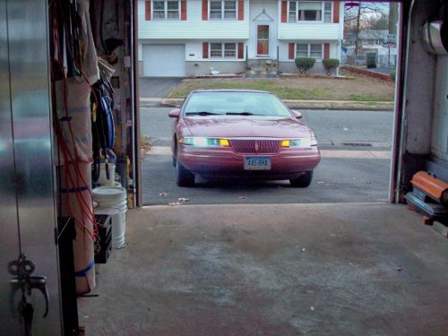

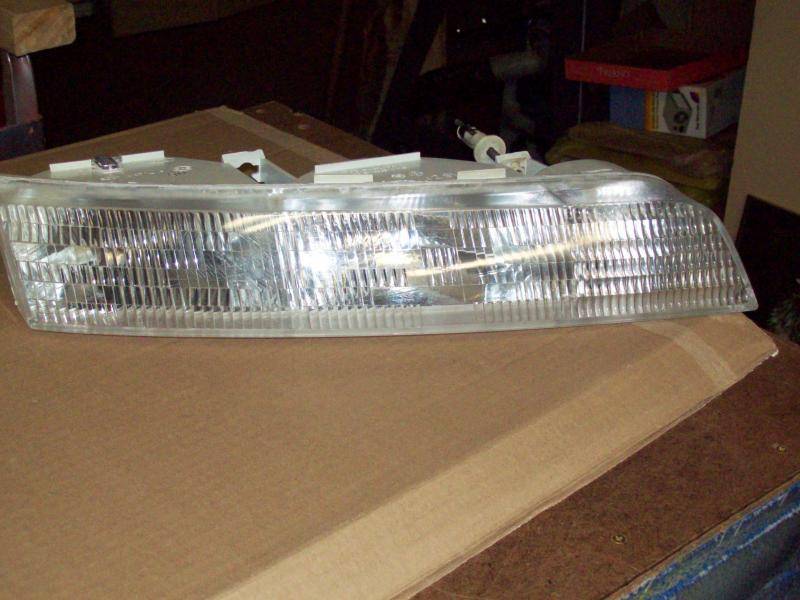

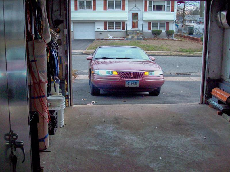

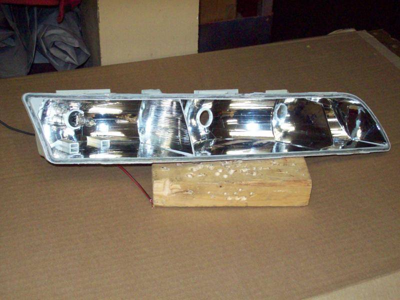

HDLT 2nd hsg.jpgGEN 1 HDLT 2.jpgHID LED 95.jpgMy 95 lights got so bad I couldn't tell if they were on. I did the chrome brite inside and cleaned and polished the lense. I added 8000K white led's and with the bubble lenses they are great. About as bright as my gen 2's. Fog lights are the answer to help in the fog. The lower the better.
