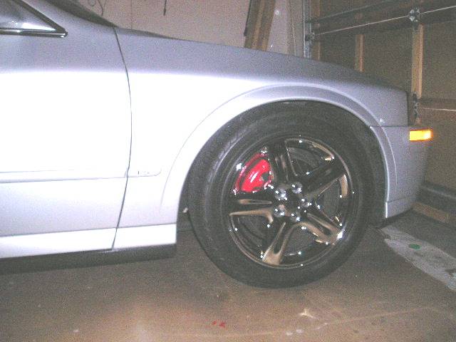

Don't remove them. Just jack up the car and use jack stands for safety. Pull the wheel off and clean the caliper with brake cleaner. Let dry completely and start taping off areas you don't want painted. This is much better than removing the caliper and then spending time bleeding the brakes. I didn't remove my calipers when I painted them and they turned out great. Here are a few pics of them before the StopTech brakes:
I painted the calipers with Dupli-Color Red Metalcast. Has a nice Candy Red look to it.

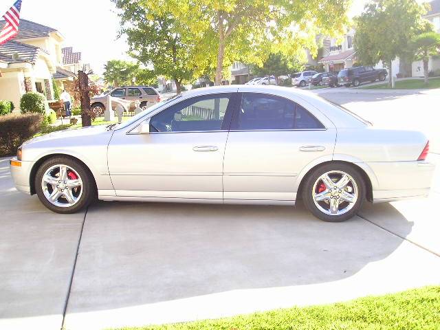

My LS is silverfrost and I painted my calipers the Dupli-color red caliper paint. My wife says my car looks like a cheap hooker (the calipers) trying to wear a designer dress (the LS)! HA!

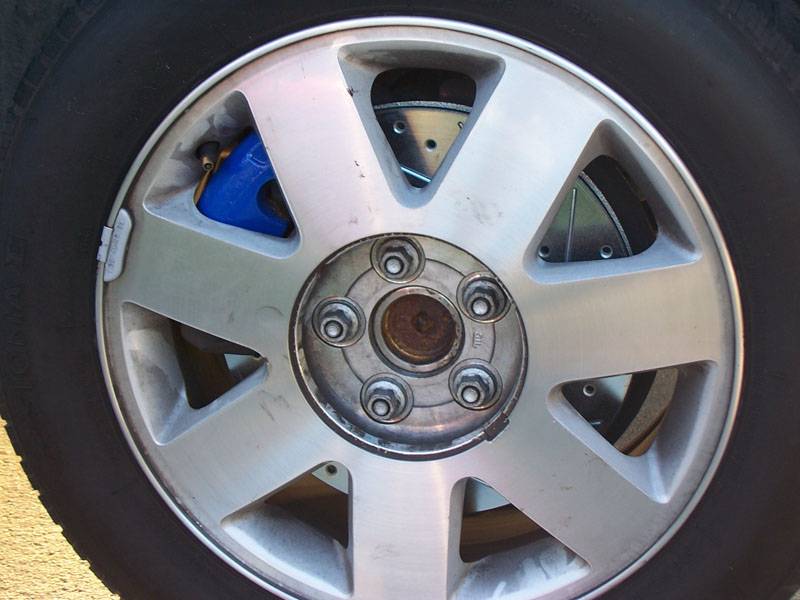

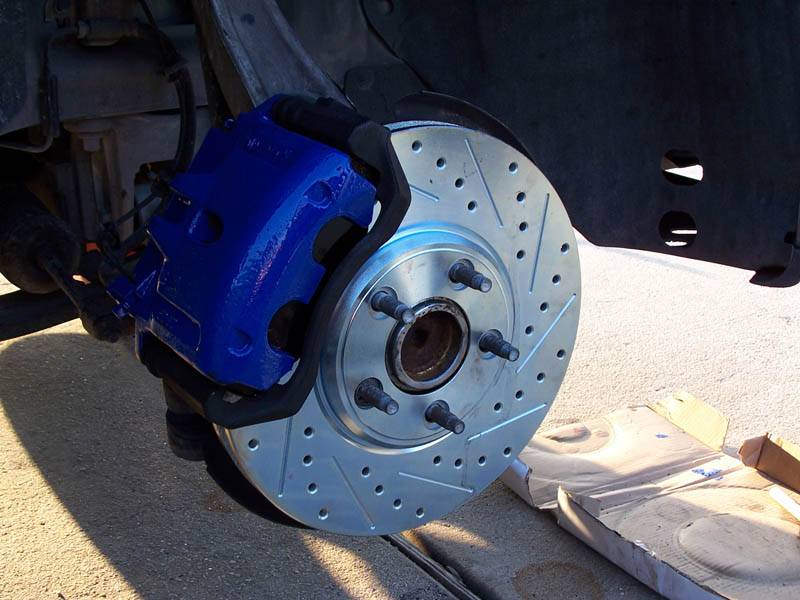

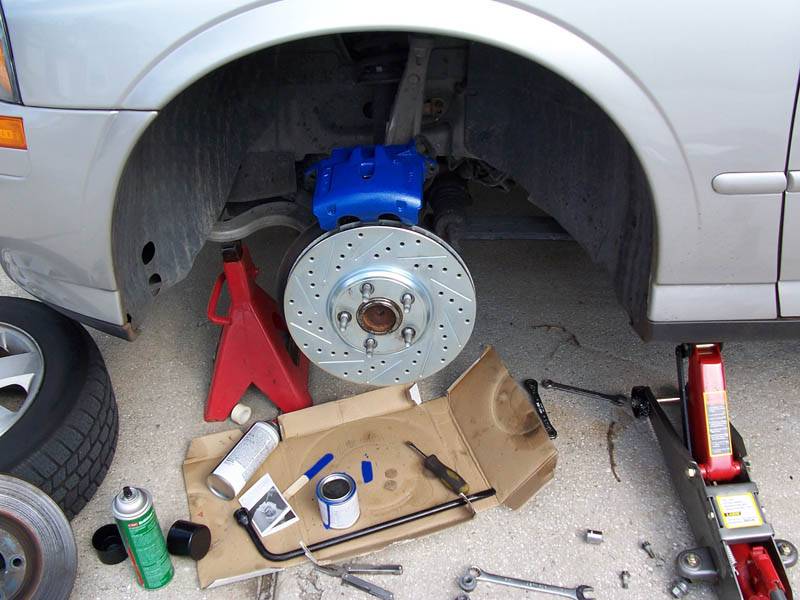

I have them done in blue with a silver car here are some pics......I love the candy red though I wish I found that stuff instead but Im happy with the dupicolor blue....I would buy some extra spundge brushes..... It comes with one but it didnt last past on caliper......but anyways here are the pics
I KNOW I KNOW Im a messy worker.....I was trying to beat the rain clouds coming in.....I put that last wheel on and all hell broke loose.....It poured like it was another hurricane....
