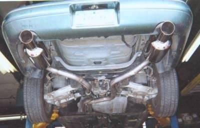

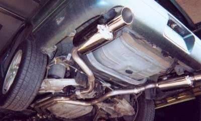

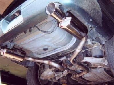

I know that the stock Mark VIII RWHP is in the 200-210 range normally. On the car that I used to own I got 242 RWHP by just adding an exhaust on it. That is a gain of anywhere from 32-42 RWHP. The car was completely stock, had @120K on the odometer, and all I had done was the exhaust. I know that the Gen 1's (93-96) run lowish 15's on the quarter mile, and when I ran mine I ran 14.438 with JUST the exhaust done on it. Now, I did not run the car before the exhaust was done, but with just the exhaust (cat-back....NO headers) I dropped close to a second (depending on what my car would have run stock on the quarter mile) with JUST exhaust work done to it.
I had true duals with 2 x-pipes, which greatly improves the breathing of the engine considering the factory exhaust is extremely restrictive, and it is not a true dual exhaust. I attached a few pix of what I had on my car, along with the video of what it sounded like.
