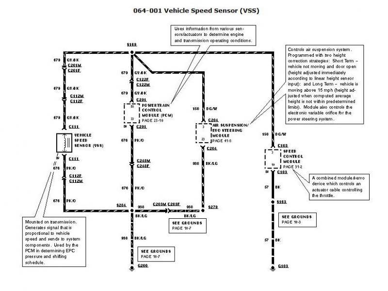

You need to change the gear on the vss.
yep. you sure do. 4.10s need the black gear from mustangs unlimited.

OK I read this 100 times so here goes. The Gen2 cars don't need the 23 tooth VSS gear because it pulls VSS from the front wheel speed sensor. The Gen1's like mine need a 23 tooth gear, Gen 1's use the trans VSS. My speedo reads 3 mph faster with 4.10's. I like that abit cause it keeps me below cop level.
I hate to bust your bubble on this one but Gen2 cars do NOT use the wheel speed sensors to get speed data. The VSS signal goes to the ABS/TC control module. The module then converts the variable AC frequency/voltage signal of the VSS to a pulsed DC signal and then distributes that signal to the data bus. If you don't believe me, jack up the ass end of a Gen2, start it up and put it in drive and let it idle.

Ok found the post, here is input by LaserSVT.
"Second gens dont get the signal from the VSS. Thats only for the suspension lowering point, speed limiter and trans shif points.
The speedo is from the ABS sensors."
Then later in post Jamie with a 97 mentions changing his VSS gear. Hmm. Confusing. Will make a thread on this to make sure.

right. so he does need to change the vss gear.
jamie had to in his black car cuz it shifted weird before he did.
speedo gear isnt for speed in gen 2s.

The VSS is located on the top of the transmission. It's held in place with one bolt. Pull it out change the gear on it and reinstall 20 minute job. I installed 373s in mine and used the purple gear for it. Ihe speedometer never varied. When I installed the 6060 transmission. It useses a completely different VSS. The pulses are faster . The speedometer was still on the money. The lowering feature, was way off. no cruise control above 15MPH. I had to put a Speed controller in it to correct the pulses from the VSS. The speedometer was never off however. Mine is a 98.

you need to change it so the air ride lowers at the correct speeds. the vss gives a signal to things that are not the speedometer.
Sorry, but that's not correct. In a Gen 2 there is no connection between the VSS and the Multiplex Communication Network that feeds the speedometer. There also isn't a connection to the Anti-Lock Brake Control Module.
The rear ABS sensors supply the speedometer data, which you can see when the car is on a dyno.
I have a Gen 2 with 4.10's, the stock VSS gear, and a correct speedo reading. The slight error that I have is caused by my tires which are slightly smaller in diameter than stock.
You can change the VSS gear all that you want, but it will not have any effect on the speedometer.
I have accounted for the gear change in my tune, which is the preferred method in a Gen 2. It can also be done by changing the VSS gear, but the larger gears don't last very long.
