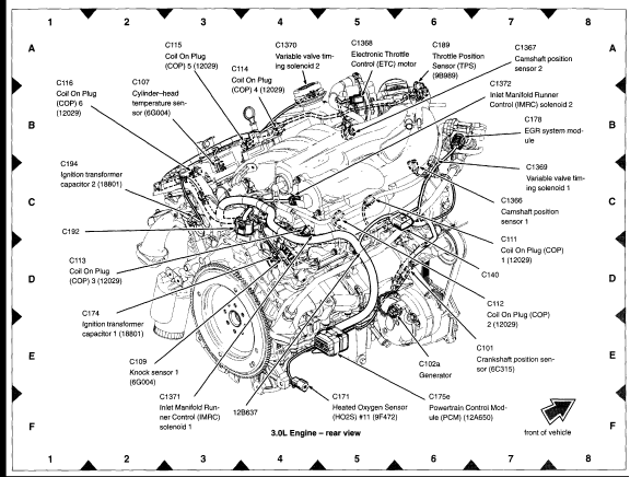

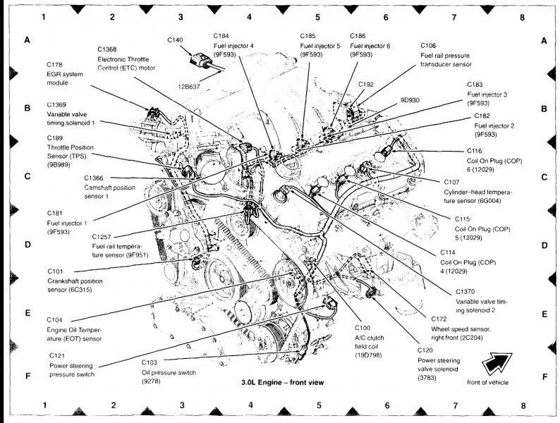

been looking everywhere online but cant seem to find the exact position of its location. any help would be appreciated. its on a 04 lincoln ls 3.0L
found it, front of engine right next to the throttle on the engine. should have a 2-pin connector. hope this helps anyone.
I believe that would be the THROTTLE position sensor.......
Look to the left of the harmonic balancer......
its actually on the engine right by i believe silver fuel lines. you have to take that air intake assembly to get to it.( room).its kind of hidden behind those lines. i replaced it already, just thought id post to let any future LVC members know the location.
