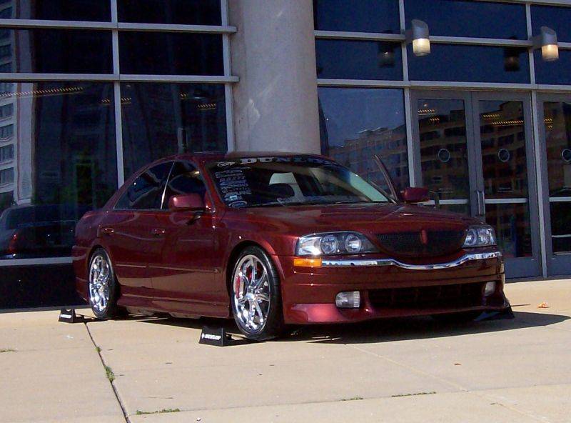

Shouldn't be a problem with the right width, offset and tire. I'm on 20s without issues. Someone with 19s can give you more details.

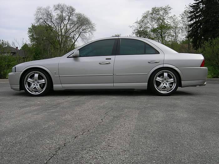

Here is my car with 19's. With a 40mm offset you can do a 245/40 w/o rubbing. I run a 255/40 in rear and 245/35 in front, but Im also lowered 2".
I use spring stiffners in back so I dont rub on big dips. I did have a 245/40 in front but rubbed on full turns because of the lowering springs. Stock height shouldnt be a problem to run 245/40's all around.
Eibach pro-kit 1.75" drop with Konig 19's & 245/35/19 Dunlops.
