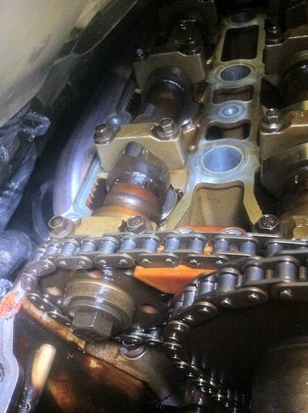

Cannot get secondary chain/tensioner off. Frustrated and tired
Justin00LS
Oct 18, 2006
402
Paducah
For those who replaced their secondary chains and tensioners with "christophers master link chain kit", how the **** did you all get the tensioners off? It looks like I could remove one of the cams but I don't really want to disturb the journals if I can avoid it. I searched and someone mentioned "remove the exhaust sprocket" to replace just the tensioner...
My chain looks perfect and everything is very clean inside the engine. I guess I could cut the chain though if I replace that too. But a dremel tool is out of the question. It would be impossible to contain the shavings.
Anyone use a chain puller?
:confused:
If it is like the 4.6's you will need to compress the tensioner and install a small pin/allen wrench or a small screw driller, that will keep the tensioner compressed so that you can remove the chain. It's similar to the primary chain tensioner.
Therein lies the problem with that method.
You can remove the cam, but that is pretty fiddly. You can also remove the sprockets, but then ensure the timing is correct.
New day. New method. Going to attempt to pop a link out of the stock chain with a chain puller. I'd prefer not to disturb any cam journals if I can avoid it. Alsp don't want to mess with timing. I'll be sure to update once I succeed/fail with removing a link :)
