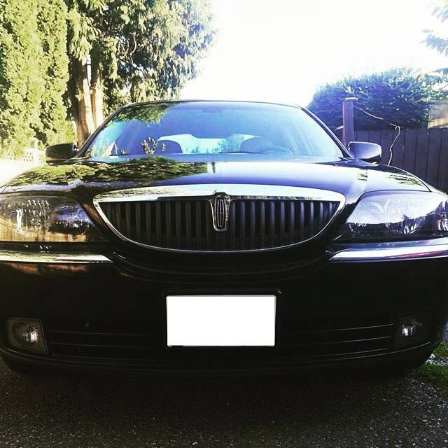

well I noticed my headlights are producing light similar to a halogen but have heard this year in particular would also come with stock HIDs with a ballast.. I cannot seem to find the ballast and wondering if I can just throw a HID bulb in there? I have done tons of research on here but im at a standstill due to this light issue. Any help will be much appreciated
Looking at the bowl pattern of your lights in that photo, I would say that you do not have stock HIDs.

Please don't. The reflectors that you have won't correctly reflect that light from the HID bulbs. It's illegal, and you will blind other drivers with the glare. You will reduce the distance that you can see at because too much light will hit the road too close to you...
If you want HIDs, search e-bay for OEM LS HID headlight assemblies.
700 canadian for a set of used ones and the car sits pretty low... how can i mod the stock reflectors.. Ive seen many LS's with ebay HIDs and on many civics too.. I appreciate your concern
