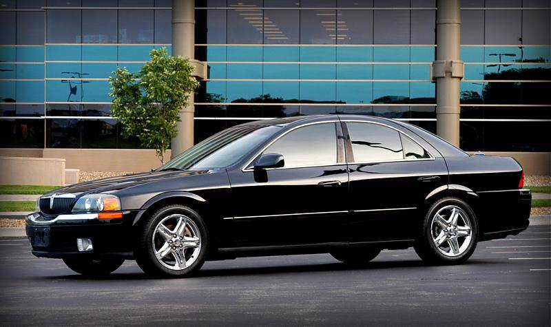

Hey guys I am new to the site. I am trying to clear something up that I have been told. I am having problems with my 2002 lincoln misfiring and the engine light continuing to come on. I was told that it is a common problem and that Ford has recently recalled the model due to "coil pack problems" Is this correct?? Any info would be helpful,
I posted a pic as well,
Thanks
Dont know if its 02, but I'm pretty sure its +03
Its not a recall, they extended the warranty and will replace the bad parts.
