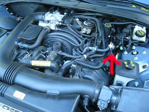

I've attached a picture. Can anyone tell me what this silver thing is and if it's something I should be checking out?
