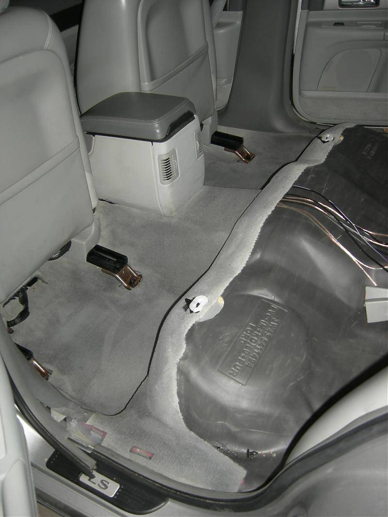

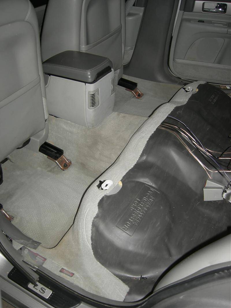

I just dye'd my car from light grey to medium grey. WHAT A DIFFERENCE!!! It looks amazing now. These pics dont do it justice. Before and After:
Ray,
The carpet looks great! What did you use?
Thanks Ken, these pics do no justice for how good the carpets look in person. The pic I took was right after this dye was applied so it still looks spotty due to it still being pretty wet, but now it is dry, it looks so good!! This is definitely a mod that is well worth the $20 and time to rub it all in. I used a carpet dye from rightlook.com
http://www.rightlook.com/index.asp?PageAction=VIEWPROD&ProdID=253
I didnt want to go too dark so I went with the medium grey. Its not as dark as I wanted so Im ordering 2 more bottles of dark grey today to darken it even more.
http://www.rightlook.com/index.asp?PageAction=VIEWPROD&ProdID=254
Looks good! Gonna do the bottoms of the doors too?
Thanks, I will do the bottom os the doors as well, the websites say that one bottle is enought to redo a whole car. Its really not. I recommend that after finding the color you want to go with get 2 bottles for all carpeting and lower doors. Just apply the dye with a 32oz spray bottle (4oz dye 28oz warm water) rub it in with a nylon bristle brush and thhen wipe off the excess from any panels and you have a new looking carpet.
