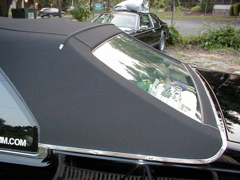

Hi Alan.
The Philadelphia chain of American Auto Glass charged me about $400.00 in 2001 to change the rear window in my 1990 Lincoln Mark VII LSC Carriage Top (also called a Roadster Top).

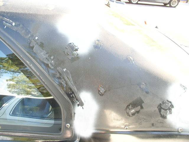

Getting rid of the fiberglass shell that's under your textile is NOT recommended. The shell is first held on by handfulls of never-dry adheasive. Second, the cap is secured with self tapping screws around the lower perimiter and across the top of the windshield. Each penetration will need to be filed down then filled then filed then filled then filed then primered three times.
Mike from NYC is in the process of doing this because his top broke off ... litterally. Pay someone to do it. Take MANY "before" pictures of the shell and the screws and the trim. If you have a sun roof that doesn't leak, ask them will they warranty against a leak after the work is done. Yes, I believe that mark VIIs should cosmetically be left stock. I also believe that I can spare an owner a headache.

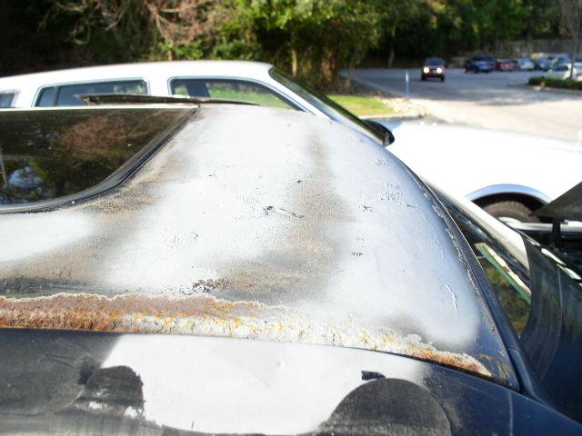

Take it off and leave it off I say. Those things seem to attract rust over time. Yes, I'm largely a cloth/vinyl top hater. :shifty: Lincoln was trying to get rid of these things with the VII.
Don't you remember what Mike's looked like at OCB in Springfild, PA?
It was a diamond in the rough I admit, but those carriage tops, especially on an LSC or SE... The design elements just clash in my eyes. Sporty, sleek, Euro flair vs stodgy '70s Detroit boat. Lincoln took a big leap with the LSC in terms of styling, driving dynamics, and trim. Putting a cloth or vinyl top on seems like a step backwards.

lol... Yeah these tops are a strange topic. It was only after being at the local junk yard and seeing one stripped of fabric that I decided to keep the one on my newest Mark VII. The amount of gunk and goo used to keep the fiberglass on, along with the many screw and rivet holes that need to be either soldered or welded shut(requiring disassembly of the interior to prevent a potential fire while welding) made my mind up.
