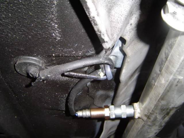

Emulators are illegal. No idea if anyone else has started making them but the last guys I knew about got raked over the coals by the EPA and they shut down their business. However, there are two other ways to do it. One, have the rear O2s programmed out. Works every time. Two, get a couple of spark plug anti-fouler plugs and install them on the rear O2 sensors. The inside needs to be drilled out, as detailed in this writeup from a Mitsubitchy site. This works, but is not guaranteed.
I would point out though, that cars without cats tend to have an unburned fuel odor about them, and cats in good working order really don't impact power or fuel economy. It's doubtful that you would notice any change unless the cats are clogged or damaged. Removing them will also make the car louder.
Anti-fouler
How it looks installed.
