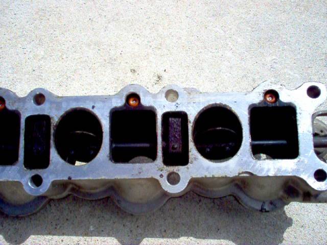

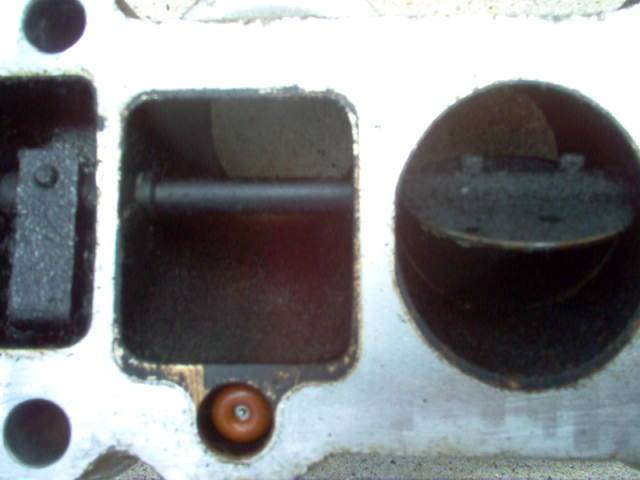

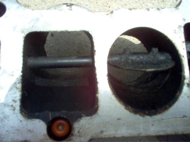

Just a word of caution when 'dumbing' it into the gas or crankcase. If your car has been very poorly maintained, be advised that these types of additives may loosen up large deposits possibly plugging oil passages, etc. If your car is in decent shape, fairly frequent use can prevent this...which to me looks like about 10 rwhp, if not more.
