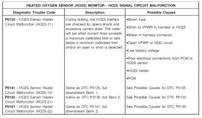

The check engine light came on in my car last night while driving home. I went to the auto parts store today and it threw P0161. Looks like this is the oxygen sensor (bank 2 sensor 2).
A little background info:
-1997
-52,000 miles
-Replaced blend door arm last weekend
-Also put a winter charge on the battery and cleaned terminals last weekend
-I noticed a critter attempted to build a nest in the engine compartment. I cleaned it out and did not notice any damaged wiring.
Not sure if anything I did over the weekend is related to the CEL.
Is this most likely the sensor itself or are there other things I should check first. If it is the sensor should I only replace the faulty sensor (downstream driver's side) or do I need to do it in pairs? Do you guys suggest the Motorcraft DY1086 or the NTK 22500?
