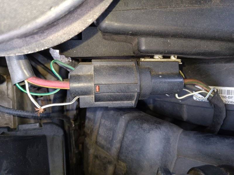

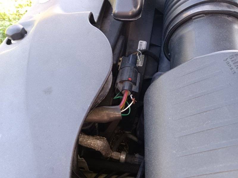

Hey man i apologize for the late response. I dont get notifications right away. I will post some pictures later today of how i have my LS fan switch wired up. I agree 100% with pulling anything off that will allow that engine to run cooler. Coil covers,engine cover,plastic skid plate all act as a oven. If you live where its real cold all the time then it makes sense to keep them on so the engine reaches optimal operating temperature quicker. And No i haven't had any problems out of my AC or Heat or anything. It runs like a champ!! The only negative thing about having you're fan running all the time is its loud sounds almost like a jet turbine lol i like it. It sounds pretty cool to me. I will post those pictures for you after work today.

Alright sorry its late but i work all day then come home and work on my Aerostar Van that im restoring. Heres the pics i promised. I pulled the toggle switch off to show you exactly which wire i cut and hooked the toggle switch into. You can see in the picture where i put the black n white wire back together. If you need a picture of the toggle switch hooked up i can post that for you as well.
