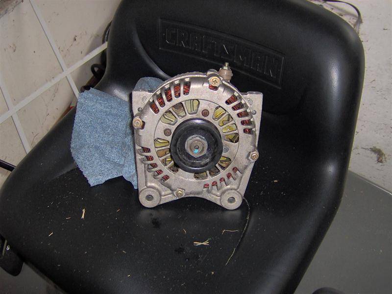

Really? The one that was in there wasn't, and I have a brand new alternator sitting here that isn't slotted either. Ya lucky SOB lol
Slots would be nice, but none of mine ever had them.
Wow, I guess there is a first for everything. That is the first alt I have seen that was not slotted. Everyone that has been on my cars, or I have purchased have had slots on the bottom.....I guess I have been a lucky SOB.....lol :D
Late model alts had the slots....... early models on the other hand, did not.

Slotted
The 96 and newer model alternators that I have seen are all slotted. The 95 and older ones are not. Rebuilds are mixed as the cases can be used for all years of Mark VIII's
