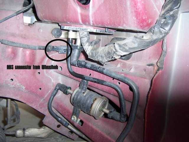

4) If you are lucky, the hub will fall out at this point. You will need to remove the plastic Wheel well to get at the ABS connector on the wheel well sheet metal.

Next pic Plastic wheel well splash shield removed to get access to the ABS connector. it will require a slight finger pressure on the tab to release the connector lock. BTW, you can also see the fuel filter for future reference. There are about 5 plastic quick fasteners. just pull out the center bullseye and then pry the big plastic donut out. There is 1 Phillips screw at the bottom of the wheel well that also needs to be removed.

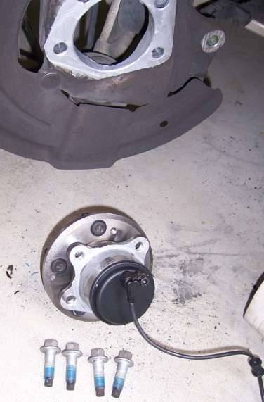

Next pic shows how the hub just fell loose after I losened the fourth and last reatinging bolt. Note the clean metal surface shown in the gap. No rust in California, "It never Rains in California..."

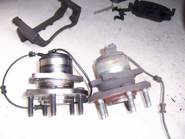

Next is new hub left, old hub right. Other than a bit of dust the old hub looks fine. It does make a kind of grumbling sound when you turn it, but it was not loose, no wobble nothing when I was working on it. Just a loud humm, my son said it sounded like a B17 bomber on a mission. Also in the background you can see the Caliper mounting frame that needs to be removed in order to remove the rotor etc.

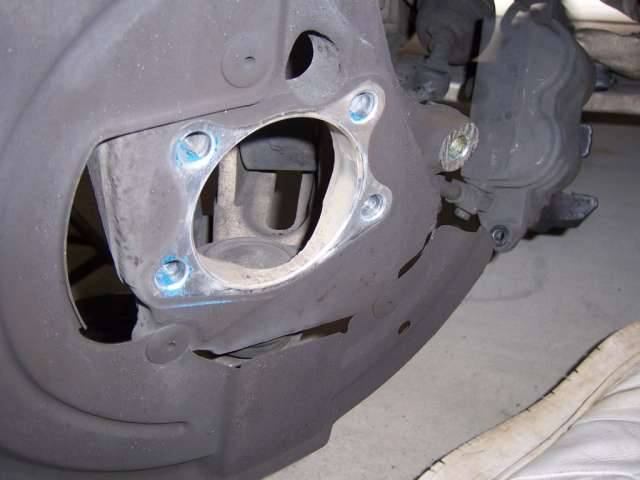

Next is the mounting hole before cleaning. No RUST, yeehaw.

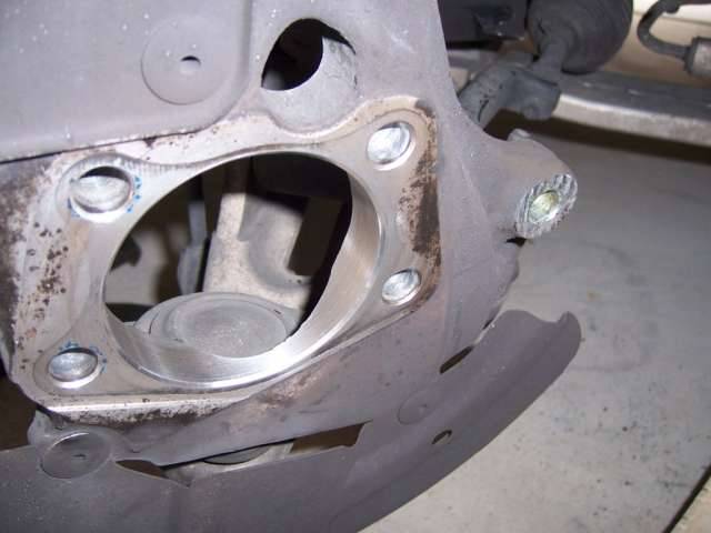

Next is the mounting after celaning with WD40 on a paper towel. If yours is rusty you should wire wheel or use sand paper to clean out the hole. DO NOT make the hole bigger, duh.
