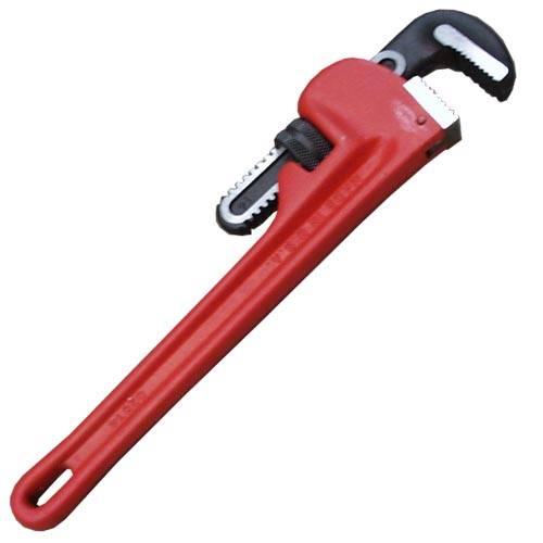

i assume your talking about your croosover tube cap, will mine got stuck/striped out so I used a pipe wrench
heres what it looks like in case you dont know, hang in there little buddy
I tried a pair of big vice grips, as tight as i could, hit it, pushed it...nothin...unless...its one of them reverse rotation kinda things. like rightey loosey, leftey tightey?
