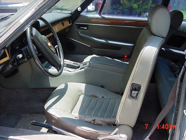

Jag XJ6 before...

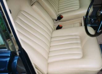

After...

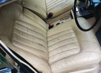

Before....

I called them once and questioned them about the process. Basically, your going to be doing something similar to wet sanding, removing the top layers of leather until the cracking is gone. You cannot 'fix' leather that is cracked all the way through.
My suggestion is that you find a local upolstery shop and have them replace the affected parts of your seat. If you want a maintenence free option, replace the most troublesome parts with a vinyl product since they dont crack.

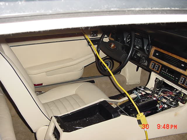

After...

Several guys I've talked to on the Mercedes M-100 site have used this product on their Mercedes leather, and that stuff is so thick it actually hardens into a cardboard like material and then tears as it cracks....
They offer a crack filler that will fill small cracks on-car, or with a glued on fabric backing can be used even on seats as bad as that Jag.
One friend has several years on his and the filler is still working well. His car looks new inside - but it was a 30 hour job - on $1600 benz front seat covers it is worth it.
