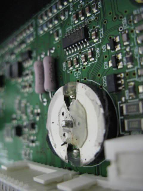

Is there any way to get rid of the stupid chime? I don't need any noises to remind me of something.
The chime is inside the cluster. It should be possible to disassemble the cluster and unsolder the chime unit, but the only one that I know of that tried it damaged his cluster and had to replace it.

I actually put a few pieces of gorilla duct tape over the lil chime inside the cluster when I took it apart to change over to the blue LED's and it muffled it big time u can still hear it very lightly but not as loud as before actually tolerable now

OPTIONS:
1) Go all out and open the cluster (at your own risk of course) and trace the + / - leads (tracks) to the chime itself,
rather than sticking a screwdriver through it or take some pliers to it ((like some have)with disastrous end results),
attempt to gracefully desolder it's connections from the back of the board. Once removed, this will leave an open
in the circuit and should really not be left like this, instead opt to run some small leads from the + / - to a red LED,
which you could run down to pretty much any place your little heart desires. ie: near ignition or to the shifter console.
- Think of this as how a hearing impaired vehicle might be set up. Instead of and audible alert the operator receives a visual instead.
- swap chime for lamp. Naturally ensure correct voltage and impedance and don't make a mess of the delicate cluster PCB.
^ I have not done anything like this myself, am just thinking out loud and you're on your own risk by attempting such. GL.
Pic of annoying chime on cluster:
