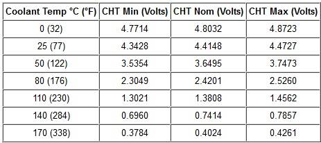

Here's a chart of the CHT voltage to expect vs engine temperature. Note that you have to measure the voltage with the sensor plugged in and the PCM powered.
