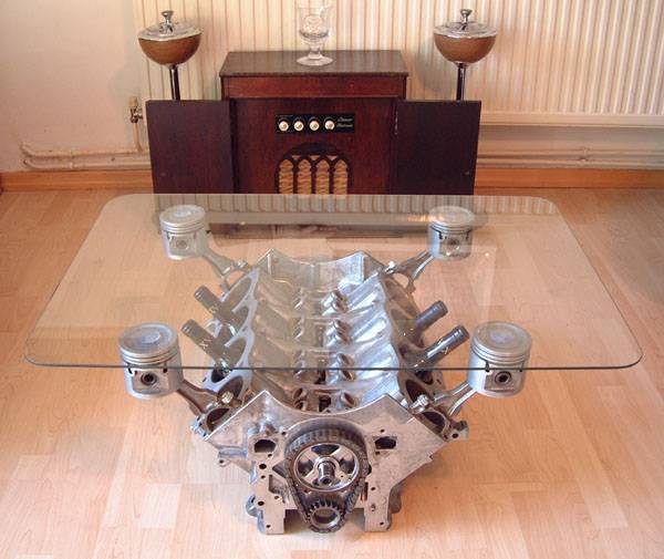

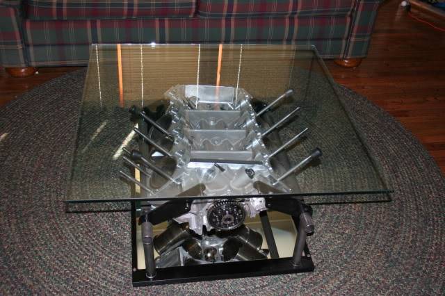

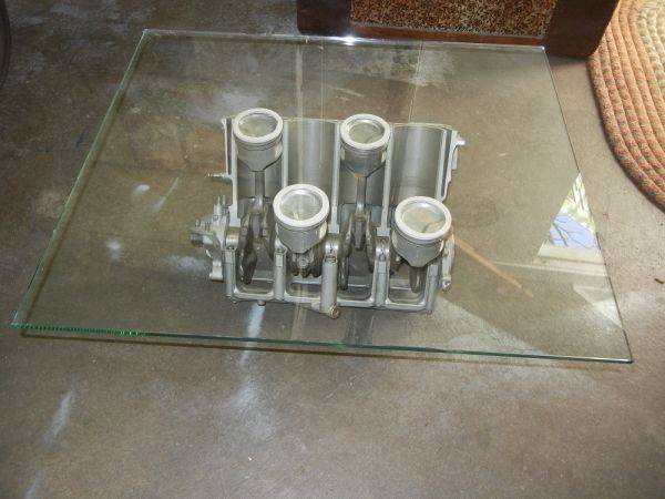

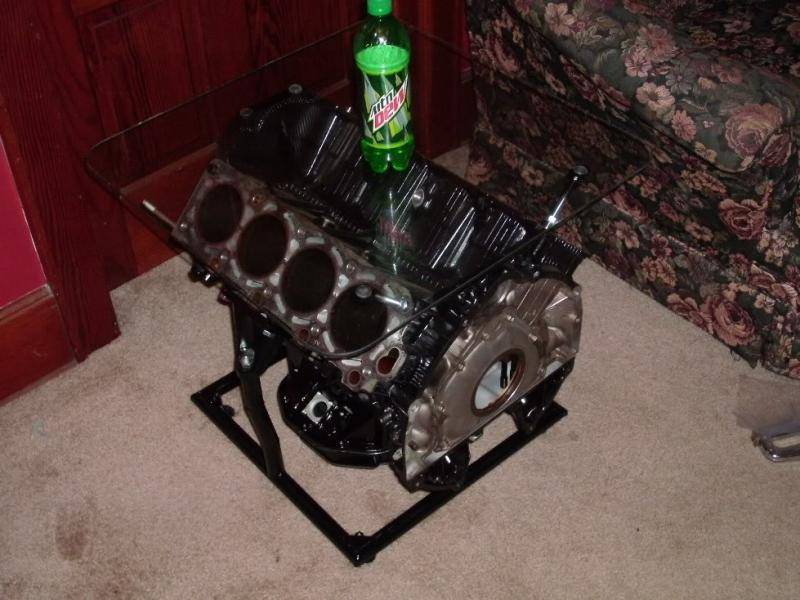

I need a table for my flat screen and AV components, i was thinking also about using my 4V Heads as a base on each side and with a mixture of glass and dimond plate build it up. Found these photos shopping around google...
