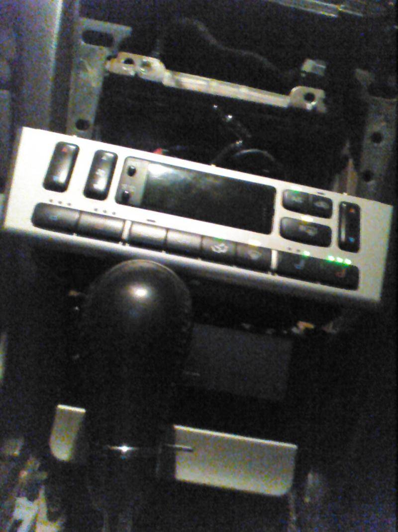

I bought a 2003 lincoln ls from an auction. radio was missing, not a big deal but ONLY Half of the climate control panel with the seat warmers on the front panel dash bpard was lighted! Is there a fuse to light the other side or is the climate control damaged and needs to be replaced?

Either the DATC (climate control) is damaged, or the wiring going to it is damaged or disconnected. If you're really lucky, they just didn't reconnect one or both connectors to the DATC when they reinstalled it after removing it to remove the radio. (This is if I correctly understand what you are saying. Are you saying that the whole climate control display is blank? If not, then it's a bad DATC.)
Only half of the display screen is lighted up. Like the passenger controls for the heated seats and what not. The driver side has no lighted side. Do you have email?
Still not clear. Are you talking about the backlighting behind the buttons? (If so, it could just be a bulb.) Or are you talking about the Vacuum fluorescent display? (Where the temperatures are displayed and some other info.) Could you post a picture?

Picture of the climate control
Is the vacuum fluorescent display completely blank?
what is the "vacuum fluorescent display"? If you mean the digital numbers that displays the temperature in the vehicle, then yes! As in the pic, only the passenger side has lights but even still they do not work!?!?
I think that we have clearly established that your DATC has an internal fault and needs to be repaired or replaced.

The vacuum fluorescent display is the greenish rectangle in the middle that displays interior and exterior temperatures and has symbols for airflow, seats on auto, blower speed, and so on.
The backlighting is just that, the legends on the buttons that light up when the headlights are on.
I think that what you have been really saying is that the annunciators on the right side aren't lighting.
BTW, those aren't just "seat warmers." Those are heated and cooled seats, and they can be set to automatically heat and cool as needed.
OK brotha thanks a lot! Going to go buy the above item in the next 2 days from a second hand store and will let you know...

You were right about the climate control. Turned right on!
