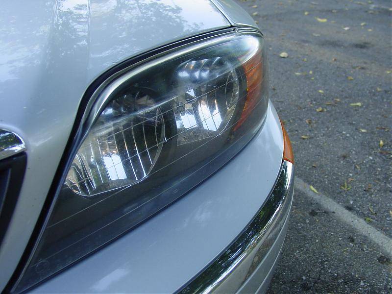

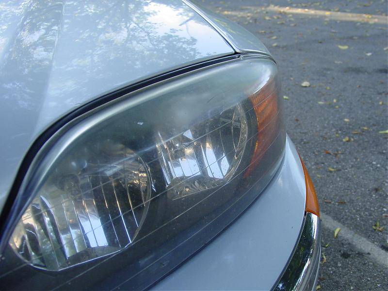

I attempted to clear up my left headlight tonight. I used Meguire's "PlastX" which you can find at any local auto parts store. It certainly improved the appearance of the headlight, visibly reducing the amount of clouding. However its still not nearly as clear as the right headlight. Overall, not impressed with this product. I'm going to try a kit a friend recommended to me. Heres some before and after pics.

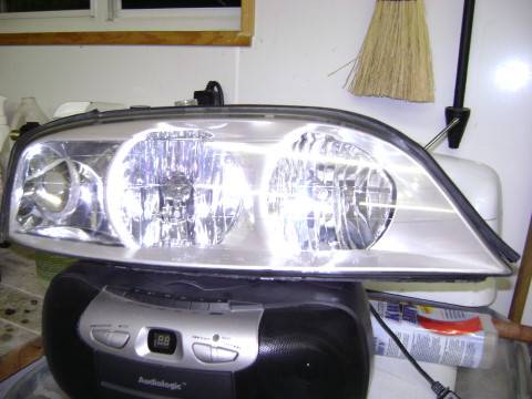

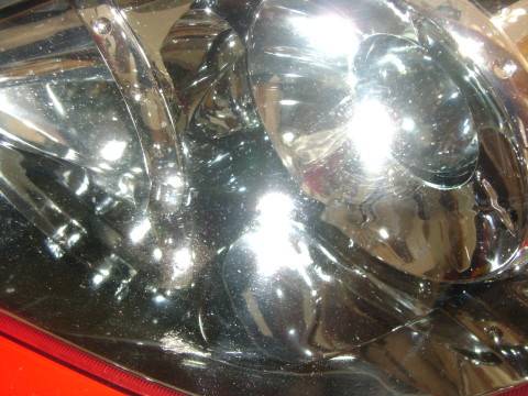

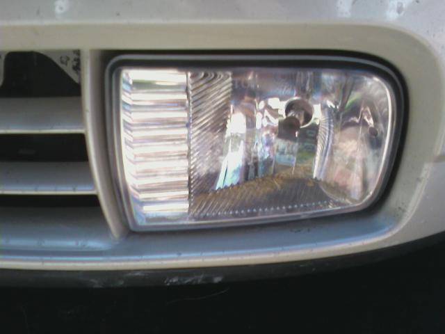

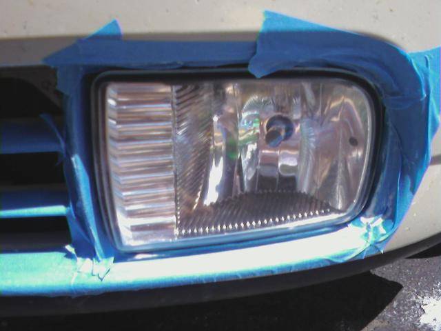

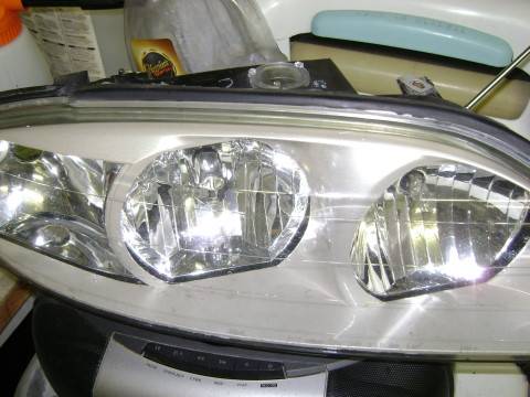

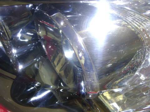

I have done this on both my headlights and fogs lights as well as on my dads Solara. There is a dramatic improvement when you are finished. My driver side headlight was turning a little yellow and I took it out following the directions in the link. I didn't take pics of my driver side but have attached a before and after of my passengers. It takes the indentations in the plastic as well.
I recommend buying a mini buffer kit to fit in a power drill to apply the rubbing compound and polish. I purchased mine at Harbor Freight tools.
Hope this helps.
You're gonna have to wet sand that out with very fine sand paper then polish it with a buffer. To keep it that way you'll have to polish them about once a week. There is a layer of protective clear coat on the headlights to protect the plastic from the sun. Once that protective coating is gone the sun will cause the plastic to deteriorate much faster than normal.
