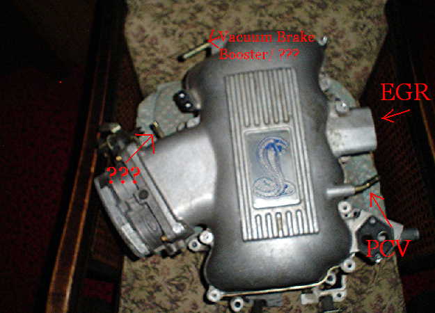

Ok, so where do these connect???
Alright, I know where the PCV and brake booster go. But lines go to the highlighted?
I'll be headed over to the garage here in a minute, I'll let you know when I get back.
The one with only question marks.........Fuel pressure regulator, and HVAC. I did'nt check the other, but I can't think of anything else, because the IMRC's are electrically opperated in the cobra intake.
I'll have to see pictures or up close to see what hooks to what. Thanks for your help, mucho appreciated...
