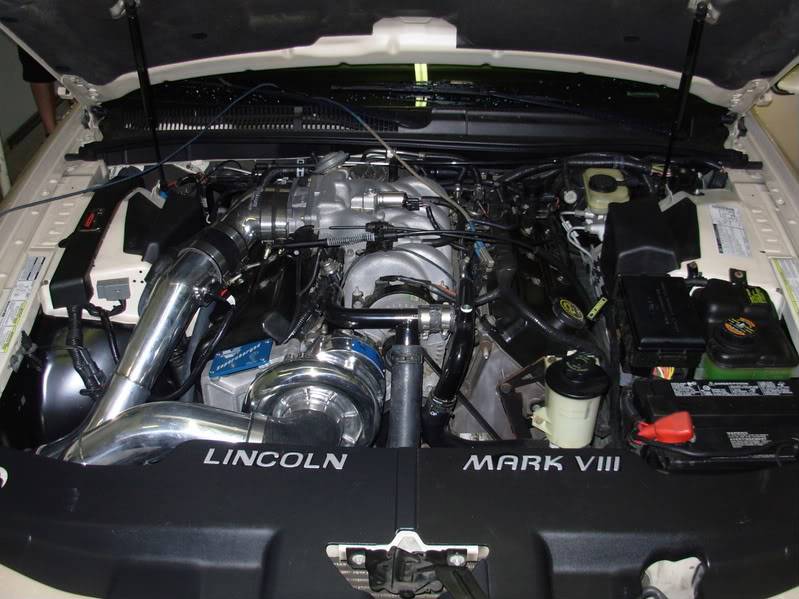

Here's a couple videos from back in the day. Set-up - stock 100k motor and intake, s-trim vortech, intercooler with blow-off valve, blow thru MAF, 60 pound injectors, SVT Focus fuel pump, and KB BAP.
I suggest keeping the stock intake until you decide to go with forged internals. Expect 400 - 450rwhp max on the stock block and stock intake if your tuner is willing to take the risk.

I'd agree with the others that the stock bottom end is indeed the limiting factor. At 400rwhp you might need see half a PSI extra with the more restrictive manifold, but you'll still see that 400whp with ease. Personally I wouldn't bother with the C heads later on either. The SC doesn't care what heads it's feeding, you already have beehive springs in your B heads, and with forced induction the port velocity difference isn't much of an issue and is balanced out with the increase in port volume.
OK, I have done so much research on this and have blown previous SN series Cobras.
First off, the centri supercharger is the way to go on a B headed car just cause you can intercool it. There is no way I would install a blower on a Mark without the Cobra plenum just cause that look is just pure awesomness! *drools*
With 8psi and an intercooler and Cobra plenum you should see around 350-360rwhp but you can safely run 12 psi as long as you have 42+lb injectors, 90mm MAF, 255lph Focus pump and Cobra rails.
The limiting factor is the rods and pistons. 450 is all they can handle and at 12psi you will be about 30 hp shy of that number. The crank can handle 700ish, I know this because I know of several cars running 670-751rwhp on stock 99-04 GT cranks and its the same crank.
The 96-98 or 99/01 kits will fit fine and the kit you look for will depend if you run your intake or a Cobras. And the only difference there is the inlet tube.
Now I love my twin screw and it is a little more fun but with B heads the only way to intercool is meth. I will be doing a meth kit some day but I hate having limited intercooling which is why i will install a 5 gallon tank so I only have to fill it once every 4 tanks of gas depending how hard I drive it.
At 7.4psi my car makes 331 rwhp and if it was intercooled I would easily see another 30-40hp. Due to high IATs I have to have it run a bit rich and not too much timing.
