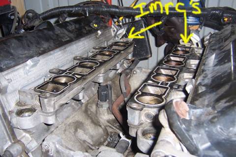

the cobra is the 'performance replacement' for the gen2 intake. the gen1 isnt bad in stock form. there is some decent gains from port matching the intake to the IMRC's. they dont exactly line up all that well. If you have a Gen2, dont even bother messing with that intake. its isnt worth the time or effort. its so horribly made that it doesnt matter..

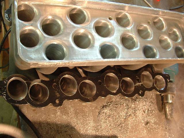

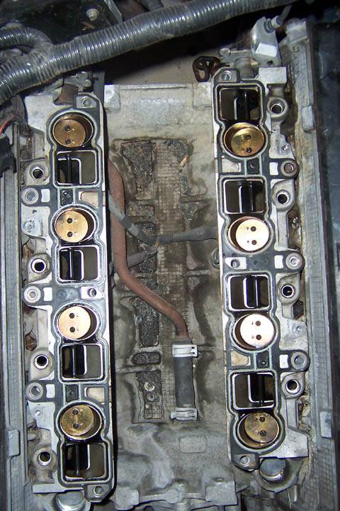

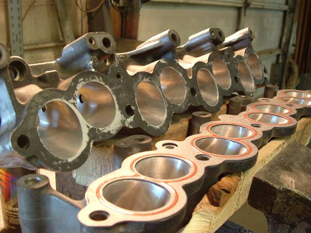

The mark has them too. The IMRCS are designed differently due to the different intakes. The top pics are of my porting project on a stock mark intake, and the bottom are of the cobra intake on my 95.
The pics of the mark system are missing the throttle butterfly's because I removed them for a project I have in the works.

MarkVIII93 said:
So they are the little vavle thingy's that open and close?
Yep.....I have the valve and throttle shaft removed to allow better high (7,500+ RPM) breathing.
