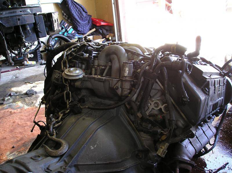

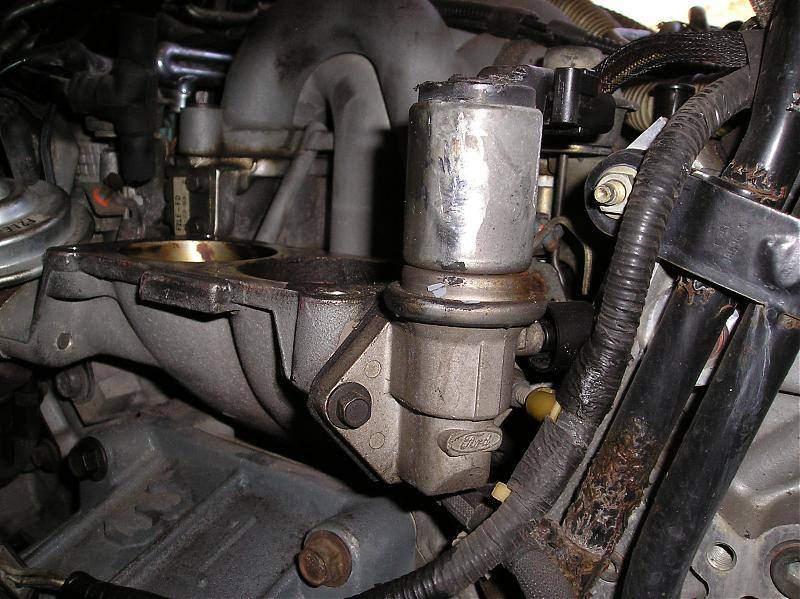

Imagine the worst possible spot next to the firewall and its right there! Actually it on the backside of the throttle body, on the intake. Kind of on the pass side.
I did mine when I pulled my tranny it made it easier but still a bitch. You might want to buy a 12 pack before you start cause you will need it.
Funny thing is... I remember alldata having a pretty decent picture of its location? try looking up something on the throttle body itself or go into Locations.
thanks, Markviiiedrea, that picture is great-I already found it by diagram on alldata, and checked it out-I is gonna take a CASE of beer to do that, what a joke-I just removed the plug to it, it idles around 500 rpm even in drive with the AC on, so it'll stay that way for now-I am in the Glenside Pa area, if anyone out there in the area feels ambitious and wants to get paid to hate this car and replace the IAC, let me know-I'm not afraid of work, but am the other side of 50 and fresh off an occipital stroke, so my vision is not so great-I found the OBD II connector (imagine puttting it over the LEFT knee) so I can clean any annoying cel as it occurs for now. thanks, guys
