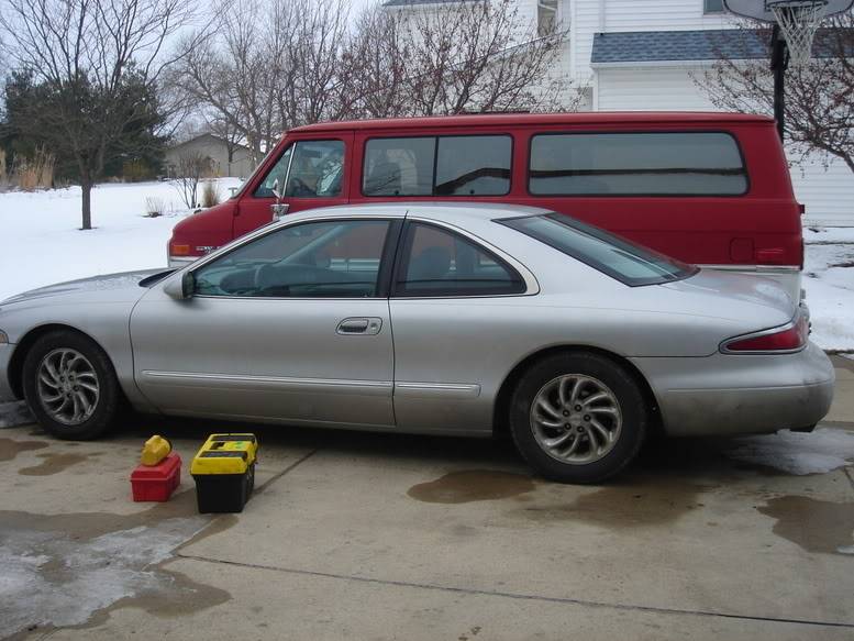

Heres my 1.5" drop, I think it has sagged a bit since
"quite a bit off" is right, make sure you get an alignment right away. Your tires will be gone in no time if you don't.
