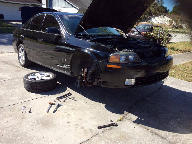

So was doing some front end work today: upper control arms, stabilizer links, steering knuckles, outer tie rods, rotors, brake pads and shocks BOTH sides. Freaking shocks. Hate the freaking shocks. Taking the spring off the first one was not a problem. But we can't get the coil compressed enough in order to get the shaft up through the top mount. MONSTER coil springs. Took them to Napa. They don't doooooo tear down and rebuild. Pep boys tried but couldn't compress the spring enough either. Why is this so difficult? WTF. Shocks from rockauto.com. Monroe sensatrac part#: 71344. Using rented compression kit from advance auto.
2000 LSE V8
Any advice would be helpful.
It's sitting in the middle of my friends driveway. Should I just get the quick struts from strutmasters?
http://www.strutmasters.com/Lincoln-LS-Suspension-Replacement-Kit-p/fd1fb.htm
2000 LSE V8

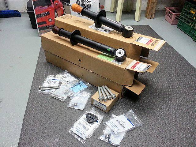

2X Front Shock Absorbers // 18124 (AST-25)
'00-'02 V8 Front "Special" (Sport) Shocks: ASH24464 or BU2Z-18V124-R or 1W4Z-18124-DA or AST25
1W43-18045-DA AST25 Shock Absorber FRONT COLOR CODE GREEN - w/PERF SUSP
2X Rear Shock Absorbers // 18125 (AT-704-G)
'00-'02 V8 Rear "Special" (Sport) Shocks: ASH24468 or BU2Z-18V125-U or XW4Z-18125-BA or AT704G
1W43-18080-BA AT704G Shock Absorber REAR COLOR CODE PURPLE - w/PERF SUSP
'00-'02 V8 Front "Performance" (Euro) Shocks: Inactive; no longer made
'00-'02 V8 Rear "Performance" (Euro) Shocks: ASHV862 or 5U2Z-18V125-VA

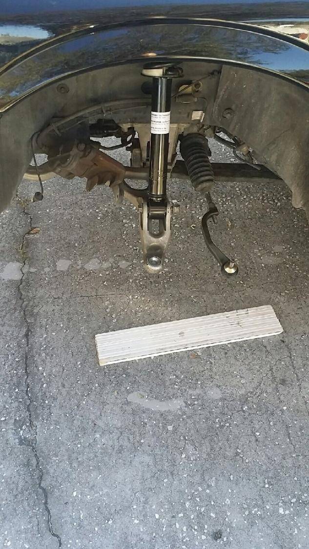

We have everything pulled out. The only thing that is currently left on the LS, on both sides, is the lower control arm and the inner tie rod. Everything else has been pulled and the coil over shock assembly has already been pulled out.
The friend who is helping me is taking them to a guy he knows that has a shop. Once they get put back together, when they need to get replaced in the future, I will be taking it to a shop and dropping it off. NEVER EVER AGAIN with these freaking Frankenstein coils EVER EVER AGAIN.
1W43-18045-DA // AST25 // Shock Absorber FRONT COLOR CODE GREEN - w/PERF SUSP
1W43-18080-BA // AT704G // Shock Absorber REAR COLOR CODE PURPLE - w/PERF SUSP
try searching: ASH24464 & ASH24468
^ plentiful all over, currently Rockauto.com $96 each, for the front Sports.​

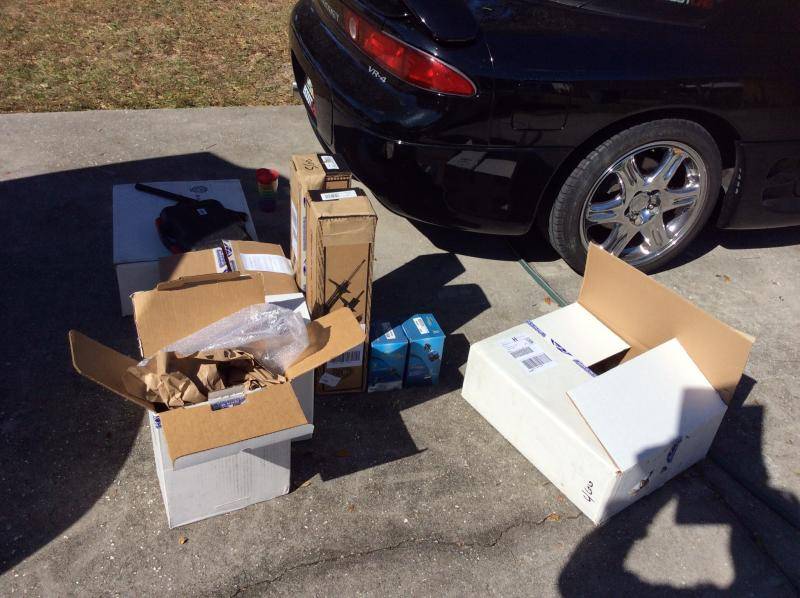

HAHA. Thanks. Just got a text his friend was able to get the new shocks loaded in the springs and they are back on the LS. on my way over now to finish up. Thanks for all the responses! image.jpg
