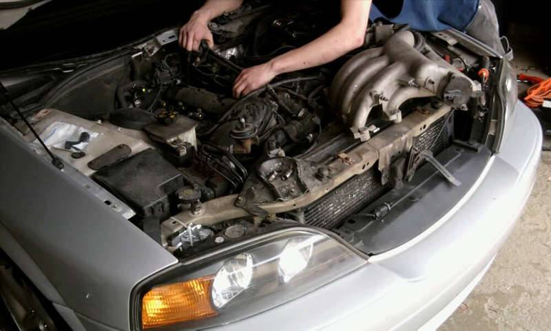

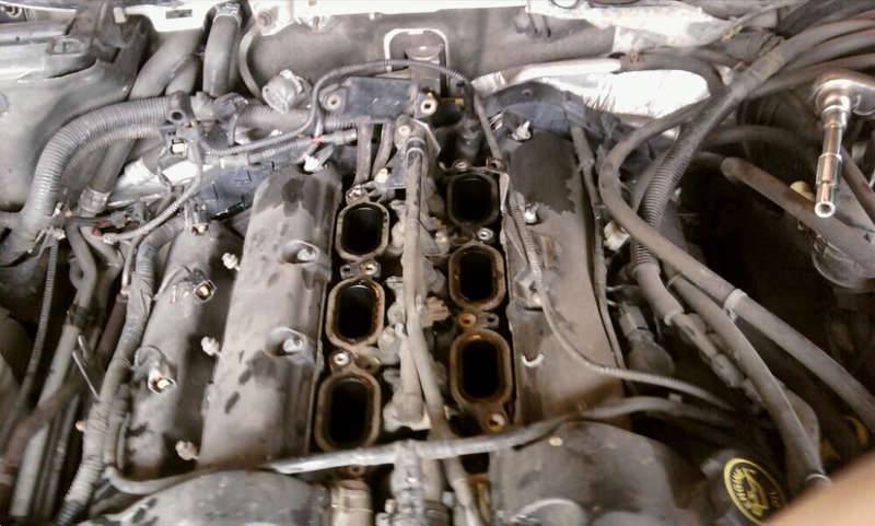

Heres some photos...
all 3 coils on the passenger side were OEM original parts.
all 3 coils on the driver's side were Motorcraft replacement.
There is definitely oil on the valve covers and into the lower intake manifold plenum, so I will be doing VCG's today as well.
We actually got the intake manifold (both upper and lower) off the car in about an hour, but we snapped 5 of the 7 bolts holding the strut tower brace, as it would appear Mike Bass Ford did not use any anti-seize on them when they did the motor install. the two bolts we were able to remove were rusted so bad that we have to clean the threaded hole out and replace the bolts. We're going to try to remove the remaining bolts and retap the holes.
Will post more pics after we finish.
Ended up getting new OEM motorcraft platinums, then gapped them to .051.
Most of them were pretty out of spec, so I'm glad I actually gapped them.
also did new VCG's and added a bit of RTV gasket maker just to be safe.
had to replace 3 vacuum lines due to the stupid hard plastic lines breaking. and the rubber joint right after the PCV elbow had a big crack in it, so I replaced that with a standard reducer from autozone.
we drilled out the bolts for the strut tower brace, and retapped for larger bolts, so that wasnt an issue.
