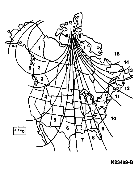

I had a similar problem once. There are multiple adjustments that can be made to the compass. I didn't know which was best so I just did all three.
I mounted a cheap magnetic compass to my dash and turned the car till that compass said it was pointing north.
I then used the message center buttons to set the car's compass to true north.
I then did the electronic calibration. My service manual says to drive the car in a circle at a speed less than 3 mph when calibrating the compass.
There's also a zone adjustment feature.
Press and hold the RESET and Compass buttons. When prompted press English/Metric.
In the car's manual, you'll find a diagram that shows a map of the continent and different settings for the part of the continent in which the car is located. Press the RESET button 'till the appropriate number appears on the display, then press English/Metric again.
Thank yoU! My goal is to get to the TRUE NORTH one... but i follow the exact instructions in the manual and it just will not do it. It'll say "Compass Zone error" so i'm not sure if its just messed up or what. But thank you for your help!
