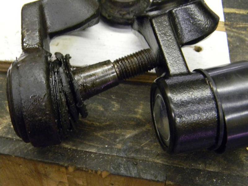

No one seem's to like Dorman, but that's what I'm running upper/lower. No problems, they looked better built then the TRW's that came off. Uppers have grease zerks, lowers don't.

Uppers have almost 15000 on them now. Lowers have almost 6000. No noises yet. Upper boots still look new, since they have the zerks I give them a shot every now and then. Purchased both from rockauto.com . Ball joint cup in lowers are a lot bigger then the original TRW's, so it holds more grease.
