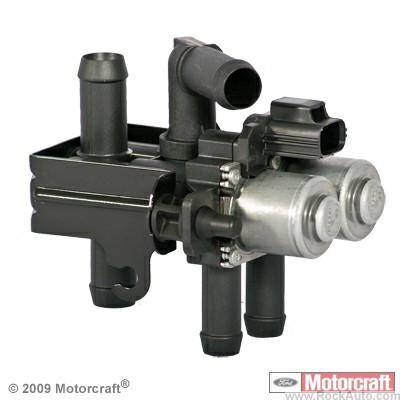

Gen I (2000-2002) has 5 connections - (YG-355)
FORD Part # XW4Z-18495-AA - GEN 1 only.
MOTORCRAFT Part # YG355

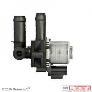

Gen II (2003-2006) has 3 connections - (YG-378)
FORD Part # 2R8Z-18495-AA - GEN 2 only.
MOTORCRAFT Part # YG378
Kinda odd he listed on paper he sold you a 1st GEN DCCV, wouldn't you say?
