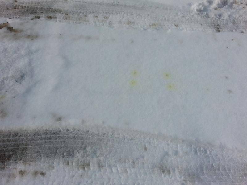

So as the title suggests I have a coolant leak around the middle of the car, well its four drip marks as you can see from the pic uploadfromtaptalk1425479675605.jpg
Any idea what this could be?
The car is a 04 LS V6
Where the coolant drips down under the car says very little about where it is actually leaking from. You're going to have to open the hood and go looking for it.
"Leaking from the middle". I'm assuming you're saying that it's leaking towards the back where the transmission connects to the engine (where the torque converter would be). In this case, it could potentially be a freeze plug, or one of the billion of hoses back there. Pray to God that it isn't a freeze plug in the back, or you're going to have to probably pull the entire engine out (it's actually very easy to pull it out, about a 3-4 hour job), and hammer that guy back in place.
Freeze plug leaks are very uncommon (on this car), degas bottle and other plastic cooling system parts leaks are very common (with age).

When my degas bottle started leaking, the coolant traveled down the frame and fell around where the fender meets the door. Maybe a little further back. I'd check that first.
