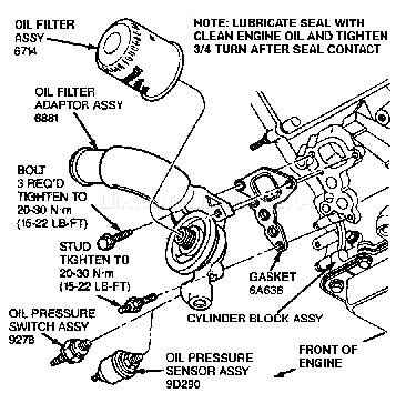

Its the oil filter adapter, this holds back oil as well as coolant. Try tighting it up first (GENTLY) then replace the gasket if that doesn't work.
You mean tighten the oil filter, or the adapter? I'm not all that familiar with the underside of the car, as I've only been under it once (when I first got it) to change the oil. And my All Data CD is of no help trying to find this oil filter adapter.
Thanks again, man.
Ok, I found some info on it (with an exploded view of the parts involved) and now know what you mean. I'm gonna give it a little tightening to see if I can't hold it off until I can get to the shop and do this on a lift - much easier on the ol' back.
Thanks for the info, Geno!
EDIT: Here's the picture for anyone that might have a similar problem...
