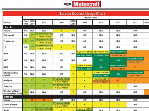

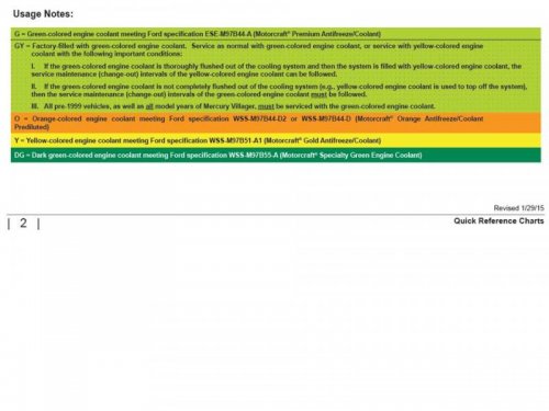

Motorcraft Coolant Usage Chart All Years Lincoln LS
Motorcraft Coolant Usage Chart (all years Lincoln LS.) Had to separate into two pages to make it show clearly.
Motorcraft Coolant Usage Chart Lincoln LS All Years_a.jpgMotorcraft Coolant Usage Chart Lincoln LS All Model Years_a2.jpg
