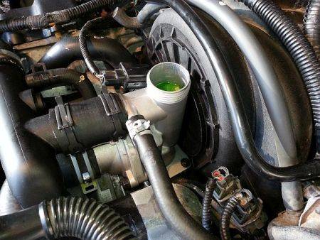

I lost the degas bottle a few years ago and have been expecting the next failure to occur soon. Have had her 15 years with 98k mi. May do a proactive overhaul before winter gets here.
- Thermostat Housing
The OEM Thermostat housing complete unit with gaskets consists on several individual parts and are yet plastics again. There is a much simpler cost effective solution for the 1st GEN LS V8.
Re&Re - Jag Aluminum Upgraded Thermostat housing - GEN 1 V8
ÜRO Parts NCE2247ADKIT
- Jaguar S Type Aluminum Thermostat Housing Kit (upgrade direct fit 1st GEN LS)
This complete kit comes with the outlet, fill cap & gaskets for less money then OEM.
It's a reliable direct fit, no nonsense all Aluminum Thermostat housing.
The Ford Thermostat P/N XW4Z-8575-CA itself is not included.
Jaguar Thermostat Housing comes with new rubber O-rings, use those provided.
Use Lincoln LS OEM thermostat not the Jaguar thermostat for that housing. (due to different release pressures)

GenII LS8 Cooling System Overhaul
Thank you very much
Rigs you are a god send can you recommend a few options for the water pump ordered 1 from auto zone but you know how they are with high school kids working there
If choosing a water pump please Note: The Motorcraft have plastic propellers where many aftermarket and ACDelco have the metal propellers which will more than likely outlast the car
