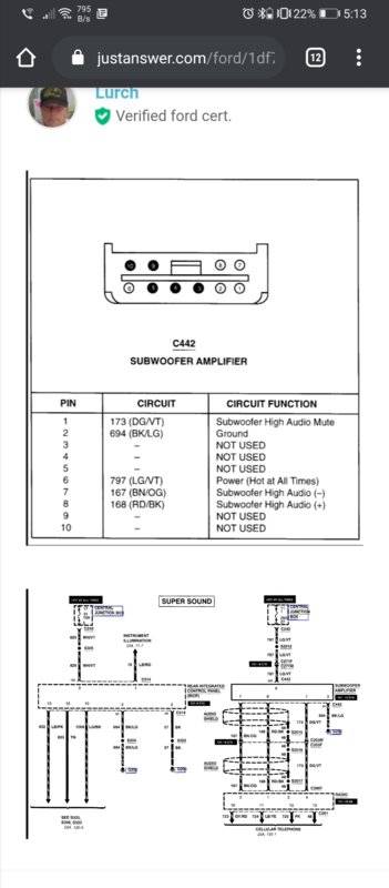

That is for the center channel and rear subs. If you don't have them (rear subs) like I didn't then you need to either find one at a wrecker and pull the amp and harness or order this connector to plug in to the harness in the trunk ( joe can correct me but I believe he said that all models equipped or not have the harness going to the back)

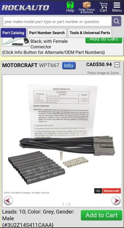

You could also try this. This is what I used on my 02 V8 Premium Sport that came with the same Alpine 6 CD THX system.
https://www.amazon.com/gp/product/B000LU8N1M/ref=ppx_yo_dt_b_asin_title_o01_s00?ie=UTF8&psc=1
Thanks for your contribution. Looking through that link is very confusing because Amazon says it does not fit, but within the Q&A some say it will fit, and others say it won’t.
I have installed several systems in several different makes and this is by far the biggest headache I’ve had. Even my friend who used to do professional installs said he won’t help because “f*ck that car” lol
It fits. I got it because it included all three plugs but I think I ended up using just two of them. The only problem with the factory THX system is it is a single channel line input to each of the center and sub amps. The sub usually isn't a problem since most systems only use a one channel feed but you'll have to connect the center image amp to either the left or right channel. I connected mine to the right. But you can also get a y-cable to connect both left and right to the single input for it. I've got one I just haven't gotten around to putting it in yet.
