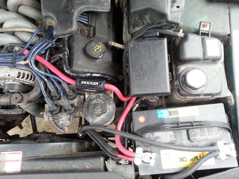

the "big 3 upgrade" refers to upgrading the charging systems cabling. usually,
1, frame to engine block
2, negative battery to frame
3, positive battery to alternator
