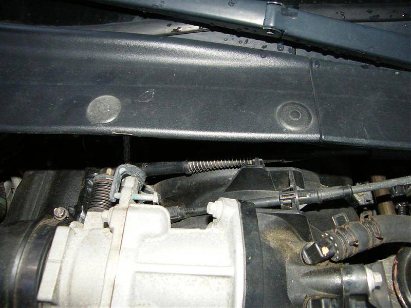

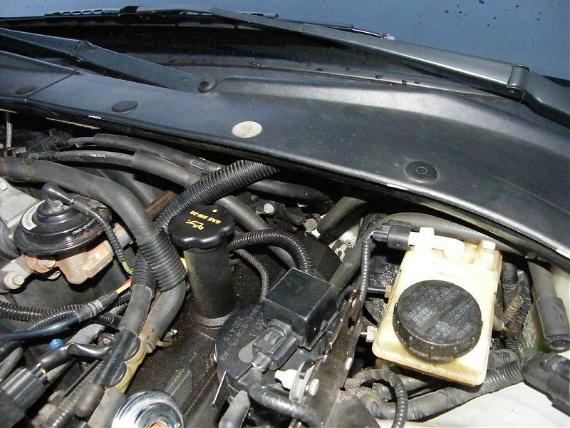

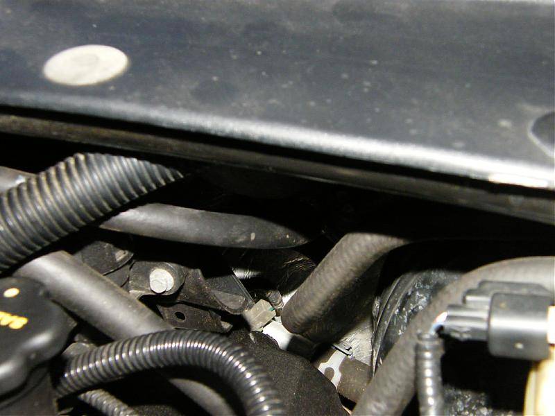

Which cable is it? One cable goes down under the brake booster and the other goes straight into the firewall

I have gen II, so I don't really know for sure. I assume it is the one going under the booster. I guess you could disconnect that one and see if you can still move the throttle with the gas pedal. If so, then you have the correct cable and will need to follow it to its other end. The servo should be there.
