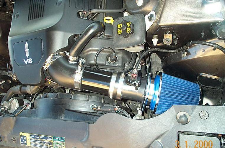

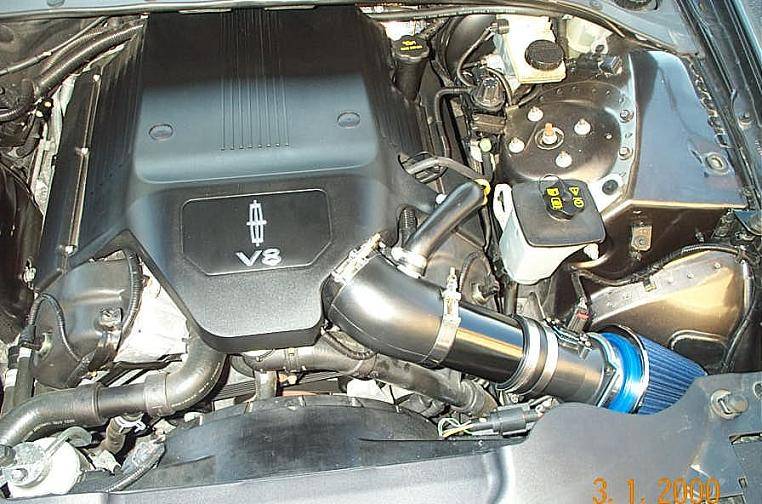

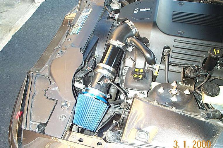

Ok, well I have been talking about doing this for a little while now. I finally got off my lazy butt and had at it. This is the first version I will offer.
I plan to offer a fenderwell CAI but will continue the fab work on that when it gets warmer out. That should only be about 1 more month till I can work on it outside in the sunshine.
With this CAI and a tune from SCT the cars really has woken up, especially by eliminating that crappy torque control and other stuff that makes the TBW so sluggish. Sure will be nice to take it to the dyno to see what numbers it puts down. Nothing big of course, but just curious to see what the exact gains are.
Here are the pics.

That's an interesting set up. When working with KKM on their version of the 03 and up V8 system they showed no real gain by replacing the stock intake tube. That's why they offer just the MAF replacement part with the filter. Some gain came from removing the air baffle attached to the tube.
I'd be interested to see what the dyno numbers say without the SCT flash.
One more observation. The stock MAF on the 03 and up LS is calibrated for the diameter and steps in the stock housing bore, if you change that, you change the output voltage. If the voltage signal is higher (ECU thinks more airflow) the mixture will be richer, and a lower voltage signal (less airflow), it will be leaner. Get too far out of the anticipated ECU range....... check engine light.

It may not gain a whole heck of a lot in terms of power, but then again intakes aren't really high power mods, so any addition when compared to the power already gained will be a welcome one. I also didn't like the look of keeping the stock intake tube, especially with all the extra crapola attached to it. Just looked too ugly to me IMO.
Have you experienced any CEL's since installing it?
Its cool, I know that. When given the calculation of air movement, you need to know what voltage (or MAF counts) you will read at a given airflow. Airflow is calculate by a volume over time. To find that volume you need to know the area of the hole in the MAS housing through which the air is moving. It is cool, I do my own tuning with SCT Advantage software on my other vehicle and know a pretty decent amount about properly tuning vehicles, and what not to do. So in answer to your question, no CEL's. :D

As long as they are sealed back up. This is something you probably already know but if they are left open a huge vacuum leak will occur that will destroy your MAS's metering capabilities.

No no no. The intake doesnt require a tune. It is self sufficient without one. I just mentioned tuning with SCT as a reference when talking about MAS voltage being thrown off by different size MAS housings. The MAS housing is the same internal dimemsions as the stock housing (area where the slot-in sensor bolts). Unless these cars (03-06) see some serious mods available for them around the corner then there really isn't a need for things such as bigger MAS housings. As you know, there is a thing called overkill; and that especially applies to a vehicle in mildly modded form like the 03+ LS's.
