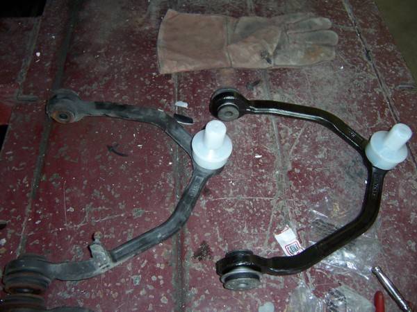

what do the broken ones look like? and do you know where you could get performance ones?
I got the Rock Auto Moog Ones. Took me a whole 15 minutes to change.
Then again, I have no motor in the lincoln, so that made it easier. But you will have to drop the struts. The pss. side fron bolt and the driver side rear bolt don't have enough room to come out without dropping the struts.
Also, those little ratchet wrenches come in very handy in those tight spots.
Its not that hard. The rear bolt is a pain to get at, by the brake unit.
You can spot a bad one by grabbing the top of your tire with both hands and pull outward, you will feel the looseness. You can see it too, the ball joint in the UCA is right above the tire, thats what goes. You change the whole arm instead of pressing in a new ball joint.

I did mine a few weeks ago. The Pass side is not too bad - but the Driver side I had to loosen the master cyl and genetly pull out of the way to get to the nut. It really is not a bad job, just be safe. I had only one stopping point when seperating the UCA from the spindle the actual joint broke apart and I had heck of a time getting the rest of the joint out of the spindle. Do a search here there are some good pics. My Lincoln CD manual does not have UCA removal - wierd.
